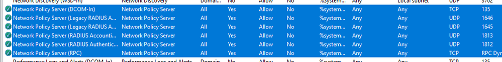

So, a little embarrassing, but it looks like stuff started working once I set the local Windows firewall on the NPS server to allow all incoming connections.
This is strange because - when installing / configuring the NPS role - the corresponding allow rules were automatically created (I had double checked that a few times while working through this process). So, maybe there is some port requirement other than UDP 1812, 1645, 1813, 1646... and TCP 135 and RPC Dynamic Ports...

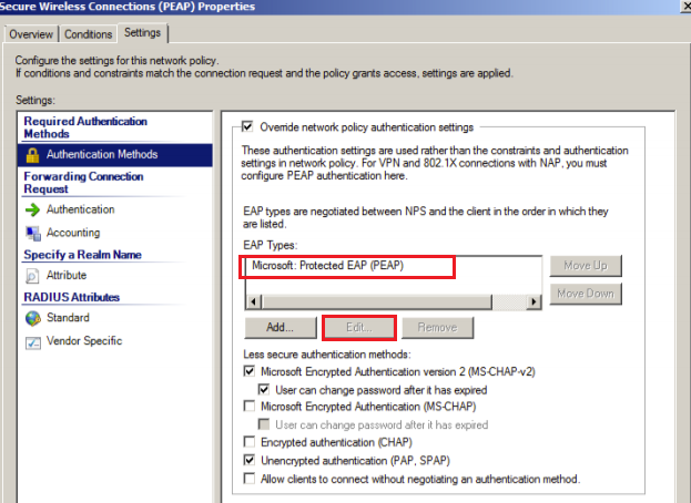

Please check and make sure auth method (EAP - PEAP) has a certificate mapped to it, else auth will not work.

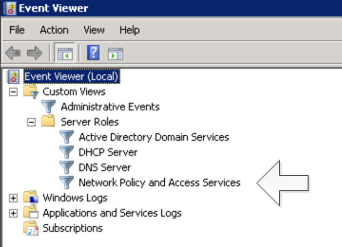

If still facing issue, check event viewer >> Customer Views >> Server Roles >> Network Policy And Access Service >> Review the most recent authentication attempt. It will give you more info like if request is even reaching the server and hitting the correct policy, and what is the reason for auth failure, etc.

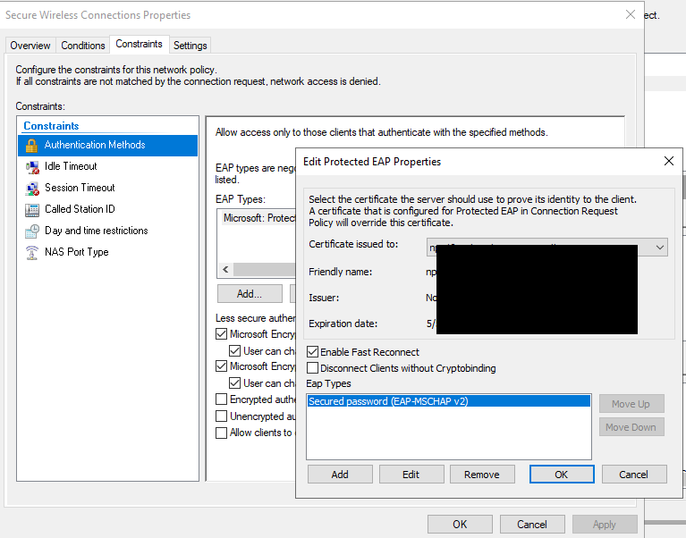

Thanks for the detailed reply;
Regarding the first part - yes - there is a certificate mapped for PEAP
Image_ images_messages_6093fe85758f933b8d56363c_bb6e7888440e2c6ef7ba962c73dfc46c_npsconfig-da719bed-881a-4faa-b2b6-d07100c4763c-297787602.png

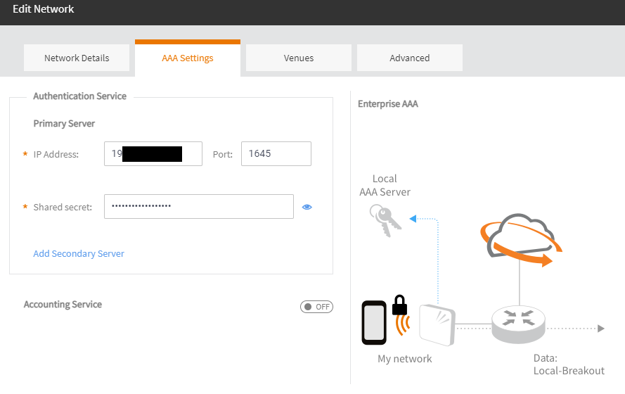

As for making sure the RADIUS server is configured correctly in the Cloud, there is nothing else aside from defining it in the WiFi network setup, correct?
Image_ images_messages_6093fe85758f933b8d56363c_04b397621ff65ca6cdafa6f525a90109_WiFitest802.1x-edef2811-ec15-4dea-9cf5-8d46a139b8e5-760113917.png
Shared secret is the same, and all AP IP addresses have been added. Again, added using cidr, but maybe I will try adding individually see if that makes a difference.
