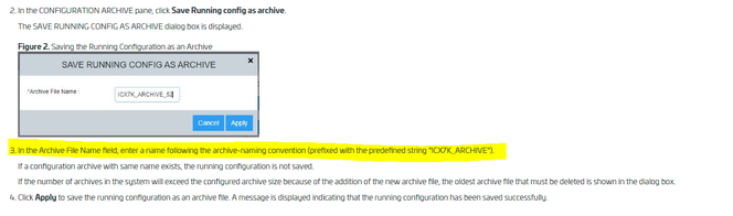

The error you mentioned is related to naming convention. Make sure prefix matches. Below is a snip from the document.
I hope this helps.

perhaps the documentation could be a bit clearer, i also struggled with this at first. as you highlighted it says
"The archive-naming convention requires archive names be prefixed with the predefined string "ICX7K_ARCHIVE"
firstly, this is somewhat incorrect, it needs to be prefixed with "ICX7K_ARCHIVE_" (note the trailing underscore), the web manual omits that part.
while you can deduce from the example the the "archive naming convention" is 2 digits from the cli docs, i never found this mentioned in detail. also it needs to be exactly 2 digits, so you might need to prefix it with 0.
