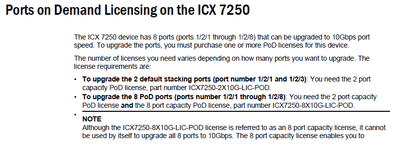

We have two Ruckus ICX 7250 Switches in Router Mode, which are stacked. Firmware version is SPR08030h.
Also we have already activated license ICX7250-10G-LIC-POD by RTU for Advanced Routing Features. Now we need 10G ports, and we are thinking to also activate RTU License for 10G ports. I have several questions regarding this activation:
1 - Do I need to restart switches after RTU will be activated?
2 - Will somehow new RTU license for 10G ports breaks already activated Advanced Routing Features?

Please see the last section here:
Since you already have 2x10 license, you will need to buy/install the 8x10 license. You can do this in production. No need to restart. If further assistance is needed, please open a support case and we can help you out (see my signature).

What licenses are present in 'show license'? POD license will not affect adv routing license.
From 8030 licensing guide:
10-21-2022 05:49 AM
Also, I should note licensing is much easier in newer code! You can check the 8090/8095 licensing guide if you are curious. You would need to upgrade to 8080f prior to jumping to the newest code.
