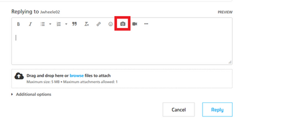

Please upload the pictures using the below option in the portal in case you end on a error while trying the procedure mentioned in the above link.
