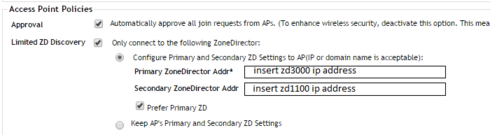

1. Make sure both ZD's have the same firmware to limit downtime.
2. Set up your Access Point Policies as below on both ZD's:
Once you have done this all AP's should migrate to the primary ZD.
You then just need to remove the Secondary ZD IP Address and your done.
