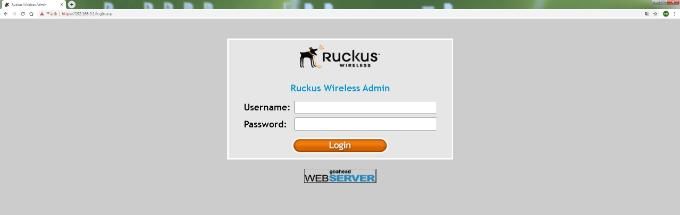

@syamantak_omer
I think I have overwritten the firmware
R730_114.0.0.0.6565.bl7
But enter the 192.168.0.1 screen
I can't log in
super/sp-admin cannot log in
Configuration.Mexxxxx
Try to log in with 8 digits
Show password error
What should I do next?
thanks

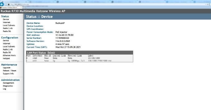

@shamantak_omer
I have successfully logged in to R730
Use IE to be able to enter and set up the machine
But Google Chrome is currently stuck on the login screen
Still further research
The remaining question is
1. Can Configure-MeXXYYZZ be closed?
2. When I press the reset button
ssh get http shows that it is not open
Are there any related settings that have not been set?
3. Is R730 POE 60w not enough? It is better to use DC?
Thank you

@lin_jia_hao please find the answers below.
1. Can Configure-MeXXYYZZ be closed? Once AP is configured, you should no longer see it. Configure the 1st SSID and see if you still get it.
ssh get http shows that it is not open. Are there any related settings that have not been set? || SSH into the AP and check if http and https is enabled.
- get http
- get https
- set http enable (to enable http)
3. Is R730 POE 60w not enough? It is better to use DC? AP needs max 31W power over POE-PoH or power adaptor. So if you have 60W available, that is more than enough.
