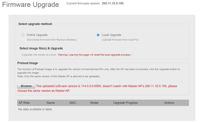

I accidentally updated the wrong firmware to R730
I have seen many articles on the website
Can successfully downgrade Unleashed 200 to Solo 100
Step
Restore the AP to the original factory initial value
Log in to the initial setup screen
Import firmware 100
This step has been unsuccessful
Request assistance
200.11.10.5.195
Is there a way to downgrade the version back
114.0.0.0.1392

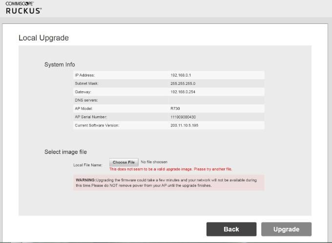

Anonymous
Not applicable
@syamantak_omer
thank you for your reply
According to the way you gave
Restore original factory settings
Neither downgrade
As picture
Is there any other way
thanks

In that case, try to upgrade using TFTP or FTP.
