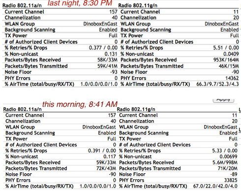

Uh uh, now I have an AP that has no clients, but %Airtime of 66.3/9.7/52.3/4.3 (total/busy/RX/TX) . Why is it RXing 52 % while there are no clients, no meshing APs? Anybody a clue?
The Noise Floor is -90, with quite some PHY Errors.

Well you have no clients currently, but the history shows the AP has transferred 74MB in the 5GHZ and 179MB in the 2,4GHz bands and the calculations are done on those data.
I'd say the AP is in good condition. On the 2,4GHz you've got only 5,5% of retries and no drops, the noise floor is OK and AT looks good.

Thanks for your reply. It seems that the values of the AirTime are pinned to the last values they had when there was a client. Or at least the value doesn't go down very fast.
Either it is an average over a longer time interval than I expected, or it is registered the same way the RF Pollution is: when there is no traffic anymore, it will keep the last known value since no new values can be registered without traffic.
Can anybody confirm this?
Here are screen shots of last night (all left the building) and this morning (nobody in yet). I confirmed that there were no stations by checking the event logs of the AP. What I find interesting is that the AirTime is still pretty high, even RX is 42% after a silent night. And the fairies obviously downloaded 5 MB during the night, while uploading 800 MB, bypassing the event logs. 😉 That might also explain the airtime...

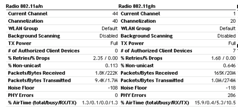

hey,
how could I troubleshoot the noise floor ?

That looks fantastic. Your noise floors are much lower (remember that dBm's are powers of 10, so the more negative the number, the lower the noise floor). You have a moderate number of PHY errors on 2.4 and none on 5GHz, but that's fairly impressive. Airtime utilization is almost all tx/rx and very little "busy".
I live in a residential area and my numbers are worse than yours. Are you having performance issues?
