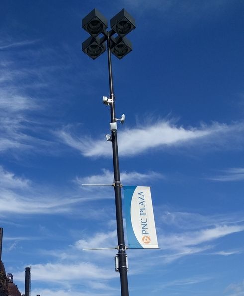

Working on a project right now for a large outdoor WIFI deployment.  We will be mounting t301s units on light poles to create 360 coverage around the light poles.  I would like to mount the APs between 10-15ft high and all three at the same height around the pole.   I was told I need to keep the APs 3ft apart so should I mount the APs at 10ft - 13ft -16ft around the pole?   What is the proper mounting for t301s 360 coverage?

As high as you can on the pole, 3 feet apart, and on different channels.

If you use the linkage brackets provided with the T301s, there should be enough horizontal separation between the APs, no more vertical separation needed.
Remember to down-tilt 10-20 degrees depending on required coverage. See https://support.ruckuswireless.com/documents/528-t301s-access-point-mounting-guide/download for details.

Image_ images_messages_5f91c42a135b77e247998bbc_37295437cd9f04975d7c74f97f7efb14_RackMultipart20160727323015fee-8160f5e5-c587-4a15-baa7-669aaccc8c58-1146908774.jpg1469622930
Pole one is complete.
