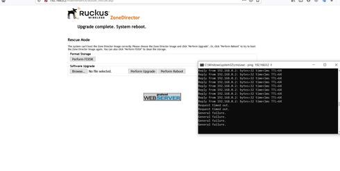

Recently I had to upgrade zd1100 from web gui but after restarting ZD, waiting for about 2 hours but nothing happened and I did hard reset but again it didn't come back and ping to default ip was unreachable.
From ruckus forum I realized that rescue mode is solution. Follow the steps I did fdisk and then upload firmware. But after it showed me "Upgrade Complete. System reboot" ZD status from off switched to red blinking. What can I do?
Image_ images_messages_5f91c3f2135b77e2478f544e_5a6f65584fa7020380a18c8fd7b0a996_RackMultipart20201002124401d60-cf6c2f36-8ccc-4c80-976a-8b467e65b9ff-783722136.JPG1601664829
Image_ images_messages_5f91c3f2135b77e2478f544e_5b94f0d3b00ed16d556d2f1e31ff306a_RackMultipart20201002109653ou7-81735022-32ca-47db-bbbe-98cf7cc33395-1641734524.JPG1601664867

Hi Ahmad
Please follow instructions from the link below to recover Zone Director. If it fails, please reach out to Support for replacement. Kindly note a hardware Warranty on the unit is necessary to process replacement.
https://support.ruckuswireless.com/articles/000001481
