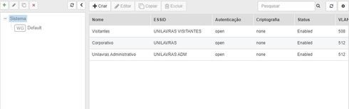

juliano_grandi
I have 3 SSID in my ZD
Image_ images_messages_5f91c454135b77e247a28255_131e083af9931abb354ebd319a98278b_RackMultipart20200917851521c4d-b205a8d9-9e08-4c3b-80c5-d3ab05e24bac-2066905851.JPG1600347967
The SSID is UNILAVRAS, the others works fine.
