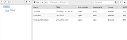

I have 3 SSID in my ZD
The SSID is UNILAVRAS, the others works fine.
