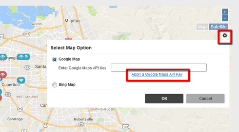

Image_ images_messages_5f91c43d135b77e2479da958_7e20279bd3510a3edd14ae52f010c0cf_3266usmrqa_inline-0dde1be6-c043-41e3-92ad-a850c74385eb-2071504680.png1503520630
If you're unable to see this configuration icon if the map loaded failed, you can change the map
setting under Configuration -> System page, like this:
Image_ images_messages_5f91c43d135b77e2479da958_28a45efcd2ff2c10780cd1fa116fde08_32661dd3jcg_inline-b6e1e18e-82ac-44e3-939d-db7757ffdece-840582771.png1503520922
We've heard from other customers that their Google Map API key resolved the issue.
Can you/your partner apply and test your own API key in this case and let us know?
Thanks and best regards.

Thanks for your suggsstion, I have solved map problem.
I get google api using my account, and apply it onto ZD.
And It disappeared error msg.
Thank you.
