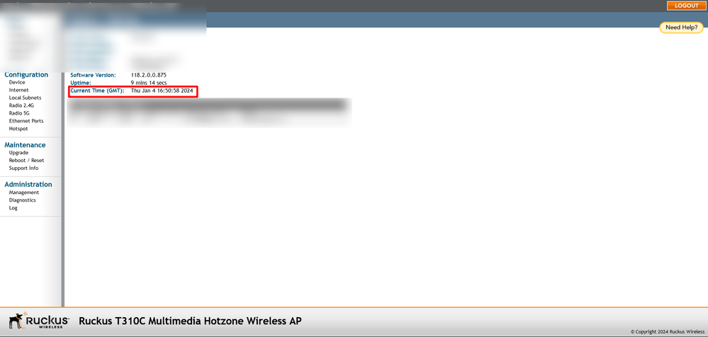

Hello everyone, i got Ruckus T310C Multimedia Hotzone Wireless AP with soft 118.2.0.0.875 , how can i configure time in it?
One of the AP showing 1970 Year another showing 2024 but time and day is incorrect

02-22-2024 11:34 PM
Hello, tried this,
** Ruckus T310C Multimedia Hotzone Wireless AP: 121803004811
rkscli: set ntp sync_interval 60
OK
rkscli: set ntp update
OK
rkscli: recvfrom: Connection refused
02-22-2024 11:38 PM
02-23-2024 12:03 AM
NTP sync interval set to 60 minutes, but nothing changed, in status device time is:
Current Time (GMT): Thu Jan 4 16:43:30 2024
