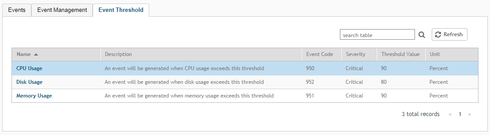

Hi Guys,
I need your suggestion or recommendation to decrease the threshold value of the vSZ. There were times that it causes our vSZ to be unusable or we cant logon to the vSZ it says "server is too busy, Please try again" Would increasing the allocated vRAM, vCPU and vHD would lessen the threshold value?? thanks
Here is the current specs of the VM. Thanks.

08-04-2019 10:01 PM
Those thresholds only set the alarm level. They should not cause the system to be unreachable. You seem to be using HD and not SSD based storage for your VM. That could potentially be a problem. You're also using thin provision disks or so it seems which can hurt io performance especially on nonSSD situations. Also, how oversubscribed is your hypervisor ram and CPU? And what physical CPU you have ? Home many real cores and of which type and how many other VMs are there on the same host?
