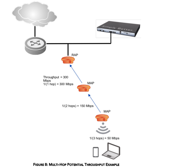

You can not add R700 APs as they do not support Unleashed management. The R710 & R720 do though and will work with the R600 upto version 200.7
I would advise taking a look at the Mesh Best Practices Guide around tree depth and maximum hops as there are throughput and latency considerations to be made with this deployment type:
Image_ images_messages_6110f4df2ace6a75f0bb9cb3_5f4aa47ec10a87af0e3037ed11ab23b1_Mesh-086dd603-afda-4f2e-9b0a-27c91b84722b-409119032.png
