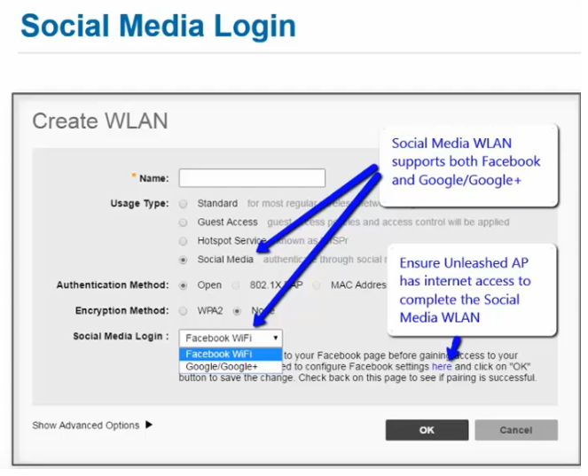

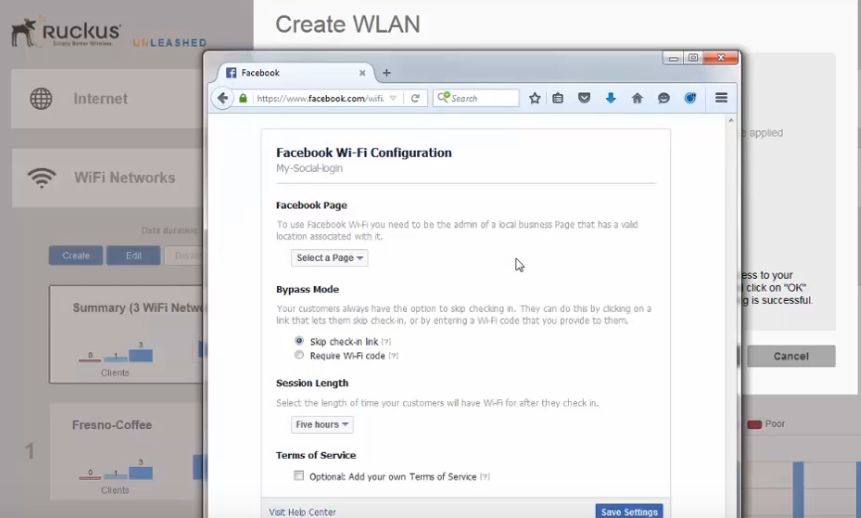

I have one more question. When I Try to make SSID with Social media authentication (Facebook), in the configuration steps, after I chose Facebook, then click on "Here" (as You can see on the picture in the attachment), the Facebook Bypass window (as this on the picture Social media login 2, second picture) doesn't apear and I can't finish my configuration. What could be a problem? thx in advance

Please follow below article.
https://support.ruckuswireless.com/articles/000010453
