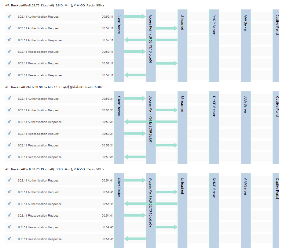

The problem is that whenever my S10+ roams at 5Ghz, it gets a new dhcp.

Hi @jungyu_park,
This seems like an issue on client device side because I do see roaming happening correctly (you can see re-association frames in the connection trace).
Please note, AP doesn't interrupt or temper client IP acquisition (other than VLAN configuration on WLAN and if you enable force DHCP).
A packet capture and AP logs may help here but for that I would suggest opening a support case for better troubleshooting and quicker resolution.

10-31-2022 08:18 AM
Looking at the capture, I found a weird thing, FT roaming is enabled on SSID but still 4 way handshake is happening post re-association.
Logically you will not see 4 way handshake happening separately if FT roaming is enabled and when client roams from one AP to another.

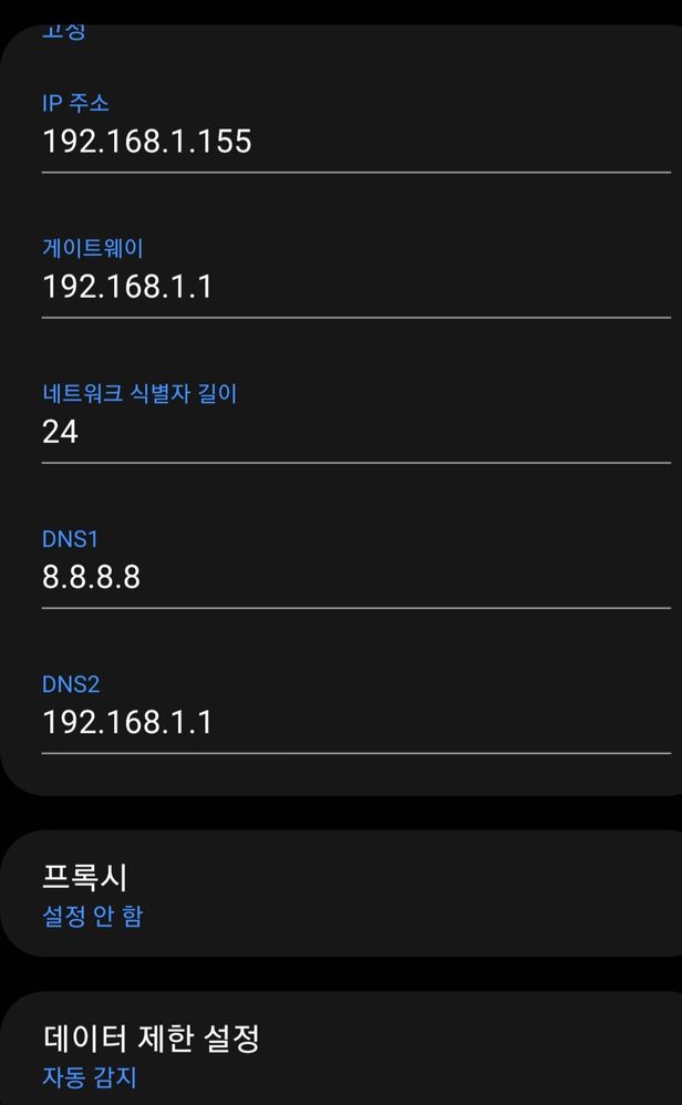

10-31-2022 09:03 AM
Even if I reserve the ip from the DHCP server, the problem still occurs, but if I set a static ip in the s10+ wifi setting, the problem does not occur.
It seems to me that this is a problem that Samsung needs to fix.
