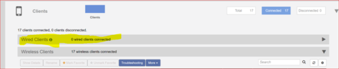

My dashboard 200.8 indicates there are no wired clients connected.  However that is not true as I have 7 wired clients connected

There are no switches, just the 7150 and 2 APs.  Here is a screenshotImage_ images_messages_5f91c497135b77e247b01511_0ef5034908500e07ccb9ee7b32d1524d_RackMultipart20200505828073od8-9ab7dfeb-8d53-4e3f-a00d-834f73a25584-537560748.PNG1588695663

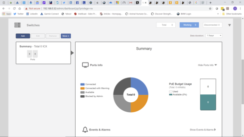

Hi Scott,
The section you are looking in Unleashed is for client connected behind AP's eth ports.
Image_ images_messages_5f91c497135b77e247b01755_6aa81531e531a79d348296136d69fe0c_RackMultipart2020050510465513n-ef1135f9-73a1-4c64-a6d8-0c4f0fb0aca7-1324926846.png1588696352
And APs port should be configured as 802.1x as informed before.

Thanks Syamantak.  I am confused a bit though, everything is connected to the 7150 and working fine.  What does the port authentication provide that I am not getting now
Hi Scott,
Just forget about ICX switch 7150 for a minute and only consider Unleashed network.
On Unleashed GUI under Clients,  you can see two types of client.
1- Client connected to APs wirelessly are called "Wireless Clients".
2- Client connected to APs on AP's eth ports are called "Wired Clients" (Please note that such wired client connected behind an AP will only show in Unleashed GUI, if APs port is configured for 802.1X authentication).
As per above, client connected behind AP's eth ports are Wired Client, not the client connected to ICX switch.
I hope it is clear now.
