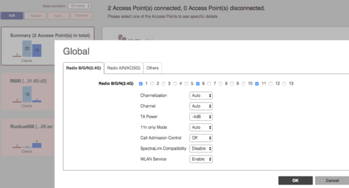

I have more than one client mostly in 2.4Ghz that are connecting not to the near  AP R600 2 meters but  they are connecting automatically to the far access point R500 where is 3-4 meters away plus kitchen and 2walls in between.
I reduced already the TX power of 2.4Ghz to -4dB,  screenshot settings attached.

Instead of adjusting the TX Power, have you tried enabling 802.11k for the WLAN and setting a low 2.4GHz percentage in Services, Radio Control and Band Balancing?  That said, you might also get better performance if you do not limit the radio to three channels.

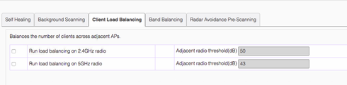

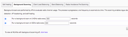

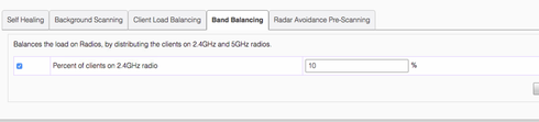

at the moment, the  firmware installed is 200.3.9.13.228 and  these are my settings Image_ images_messages_5f91c435135b77e2479bba1a_5f8a6f5620e0ab3800d8ff0810f1b869_RackMultipart2017120557207134w-a3c4d754-890e-4dbe-b939-b3a29fecbe92-1294214613.png1512508567Image_ images_messages_5f91c435135b77e2479bba1a_283726c8b2570f7fdaad3c4684c9c768_RackMultipart20171205790686y4j-53f86783-da7c-4220-8d1e-bf471bc84380-1459984462.png1512508575Image_ images_messages_5f91c435135b77e2479bba1a_d69fabada12672e293969e684a1b0c20_RackMultipart20171205819041qi5-f9b129f4-7129-430c-b9fc-364ebacab157-175152020.png1512508581Image_ images_messages_5f91c435135b77e2479bba1a_feea6392f72b36709e648d9eeba8d837_RackMultipart2017120579068q9m4-bc74d484-1df4-42dc-ac86-f5ea851b63b6-1180563464.png1512508543Image_ images_messages_5f91c435135b77e2479bba1a_321212ffe575ce6d5281f722445e6b0a_RackMultipart201712051874610y4-c09651c5-4fd4-44f8-bffb-edcc1be7dcd9-1769034163.png1512508554
1 the band balancing at the moment is set to 10% shall I drop to 2% ?
2 do I need also enable the "band balancing" in the WLAN to make the 1 option working ?
daniel_m
Contributor
I don't know if 2% will help more, but you do need Band Balancing enabled. Like I mentioned, you might also want to try enabling 802.11k.
