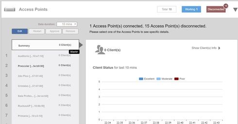

Unleashed dashboard has never worked, it just doesnt load and always pushing me off sessions, does any one have the same problem???

Image_ images_messages_5f91c437135b77e2479c1a03_3dadb0a6cd6bf022b0695998db56a2a7_RackMultipart20180228509811j6o-f4549059-cbae-45de-86f0-0c7e431ad871-1970380811.jpg1519789597
I have 16 APs, I can see the mac in the switch but they doesnt appear on dashboard, also always logs me off.

marco_quirarte
Existe la posibilidad de que otro de los AP's se haya promovido como master y que el grueso de tus AP ́s esté asociado a ese otro master.
Prueba apagando el AP del cual mandas la captura de pantalla. Y trata de entrar nuevamente a tu dashboard.
There is the possibility that another of the AP's has been promoted as a master and that the bulk of your AP's is associated with that other master.
Try turning off the AP from which you send the screenshot. And try to enter your dashboard again.
