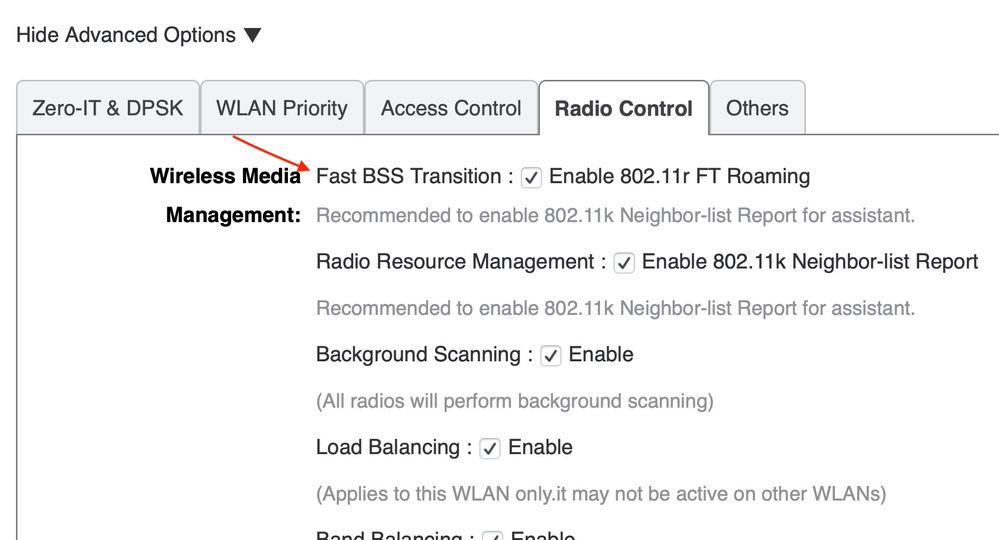

I see it in under radio control. Are you using WPA3 or the mixed WPA2/WPA3 encryption method? 802.11r was not yet available on those wlan when last I checked.
yes, for this wifi is set wpa3/mixed
but it seems to work with the 802.11k feature!
thanks a lot!
