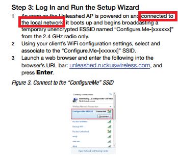

It says that the AP needs to be connected to the local network in the QSG:
Here is the link to the QSG:
https://ruckus-support.s3.amazonaws.com/private/documents/850/Unleashed%20R500%20QSG%20-%20Rev%20C%2...
Good Luck!
Good Luck!

Unless you flash the AP directly connected with factory default (192.168.0.1), the local DHCP will assign your Unleashed APs an address.
That's why they advertise the Configure.ME-XXYYZZ SSID. Once the first AP is configured as Unleashed Master AP, it can be connected
to the local network, whether you configured it in standalone, or network-connected state. After configuration, look for the initial SSID that
you configured during the Startup Wizard, and use the 'unleashed.ruckuswireless.com' administration URL for access.
All additional Unleashed APs will join the Master AP controller.
