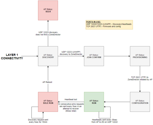

Heartbeats are sent between the controller and the AP, usually in specific increments. Depends on which controller you are using, but here's a reference for AP to ZD that I made, keep in mind this is unofficial but pretty close:

04-27-2019 11:50 PM
Thanks for this interesting explanation Nick. In this case the first AP set up acts as controller as unleashed is ‘controller less’. I will raise a case with Ruckus support to see how I might overcome this problem. Thanks again. Steve
