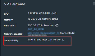

Hey Folks,
we are using vSZ in a VMware Environment, and since deployment the virtual Hardware Version of the VM is Compatibility ESXi 5.1 and later (VM version 9). Is it possible to upgrade the virtual Hardware?
Regards
Peter

Hello Vasanth,
We are using:
Controller Version 6.1.2.0.487
Control Plane Software Version 6.1.2.0.253
AP Firmware Version 6.1.2.0.2104
with AP Patch: 6.1.2.0.2230
Yes i mean the ESXi VM Version to a newer Version:
Regards
Peter

the upgrade process itself isnt an issue. we did it a lot of times. but in the past we noticed some linux appliance dont like it if the hardware version is upgraded to a newer level, hence i was asking if there are already some experiences, cause the initial ovf template ist delivered with version 9.
i think i will just try and see what will happen.
