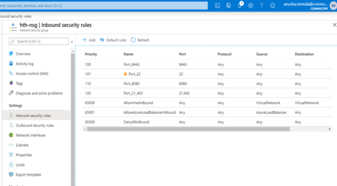

I've installed virtual smart zone v5.2 in my Azure portal and have the Smart Zone up and running however having real difficultly finding the correct and exact ports i need to open up on my Azure Network Interface for the virtual Server.
Has anyone here got the exact ports that are required to make the Smart Zone work.

I don't know MS/Azure environment, but the ports that need to pass through a firewall are outlined in this KBA:
https://support.ruckuswireless.com/articles/000003402

Hi Roger,
> Give the highest priority to the ports 8443(HTTPS) and 22(SSH)
Image_ images_messages_5f91c44b135b77e247a096be_e1c4b82bb49d57480c3b28d8800d3a19_RackMultipart20200423340455gmo-c65c7ab8-775f-42bb-88b6-6eca32363cbe-1104447464.png1587654281
> Firewall ports are also mentioned in the vSZ Getting Started Guide.
