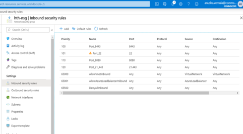

Azure Ports for Smartzone.
I've installed virtual smart zone v5.2 in my Azure portal and have the Smart Zone up and running however having real difficultly finding the correct and exact ports i need to open up on my Azure Network Interface for the virtual Server.
Has anyone here got the exact ports that are required to make the Smart Zone work.

I don't know MS/Azure environment, but the ports that need to pass through a firewall are outlined in this KBA:

04-23-2020 08:06 AM
Hi Roger,
> Give the highest priority to the ports 8443(HTTPS) and 22(SSH)
> Firewall ports are also mentioned in the vSZ Getting Started Guide.
-Anusha
-Anusha
