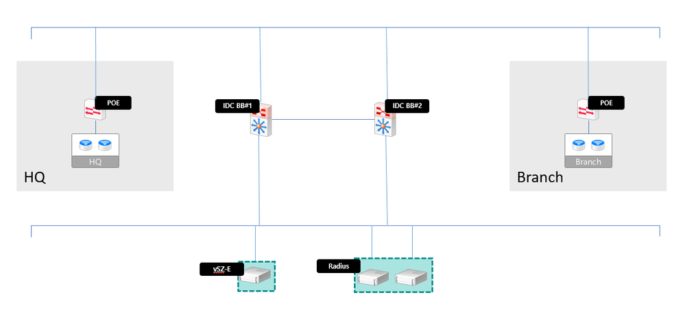

I am writing because I have an inquiry about the controller and authentication server.
1. You are using 2 SSIDs and the same Radius server.
2. MAC Authentication + PSK is in use.
3. After connecting to SSID A, when connecting to SSID B, it is possible to access without authentication.
4. Is there a way to get authentication for each SSID from the authentication server of the same IP?

01-10-2023 01:23 AM
Hi Parik_MN
Thank you for your reply
Headquarters and branch offices have different SSIDs
The authentication server is the same, and the DB has both the MAC address of the branch office and the head office.
When an employee of a branch office accessed the head office, it accessed without authentication.

Hi @kim_seonmyeong,
I believe there are no group attributes nor conditions configured in the AAA server to differentiate the client Auth request as per SSID. Please feel free to contact Ruckus Support and open a ticket for further investigation on the same.
