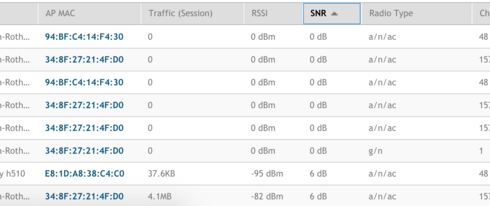

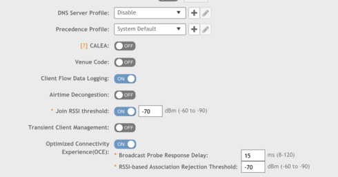

While using OCE i expect to see a 'Smart Roam' type threshold where clients not meeting minimum defined RSSI would be prevented from joining the SSIDs by ACL. instead, just as many poorly performing clients are able to connect. any "best practices" Ican read to help me kick off these poorly performing clients?Image_ images_messages_5f91c3ff135b77e24791067e_637849eac196f85384c470624096f3d7_RackMultipart2019090491768g6mi-9e86f971-80fa-4b6c-97d3-72c136824952-104259297.png1567610096Image_ images_messages_5f91c3ff135b77e24791067e_3071519e89b389d6b88508f805c8c498_RackMultipart20190904493211xvz-e2e1266a-0c3a-41a7-99a9-f9471ca71490-1934557232.png1567610112

I'd believe that maybe the stations that don't support OCE, that'd be the reason they're still able to connect to the AP even with bad signal levels.
