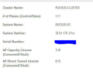

Totally there are three APs in the network, out of which two show online third doesnt. Am I right ?
Can you share the licensing screenshot too please ?
Abilash PR.
thats correct, the previous 2 are there not the 3rd im trying to add to SZ
Image_ images_messages_5f91c477135b77e247aa6559_e6dd157bc3855e2b9cd6eae104d6bcd7_RackMultipart2018110872084vu4u-6c4810ae-0240-444a-a453-02373c8d4941-186928098.png1541705665

this didnt work....it did  the same thing...SZ is saying it has 3 AP's but not seeing the AP in the AP tab
