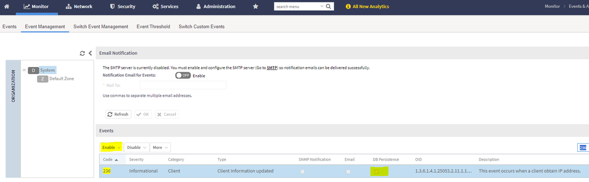

Hello friends, I have a problem, I currently cannot see the code 236 events, this information is useful to determine problems with the radius. But I see that I no longer have these logs. Previously I could see them. I don't know how long I've had this problem. Is there a way I can see them?

The event code 236 is to notify when a client gets an IP address as shown in the image below:

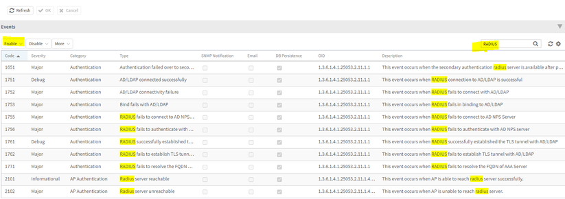

The RADIUS related events are as follows:
You can enable the required ones using the Enable option available above the top of the list, and the events can be then sent via SNMP Notification, Email or DB persistence (if disabled on SZ DB persistence)
