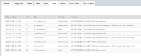

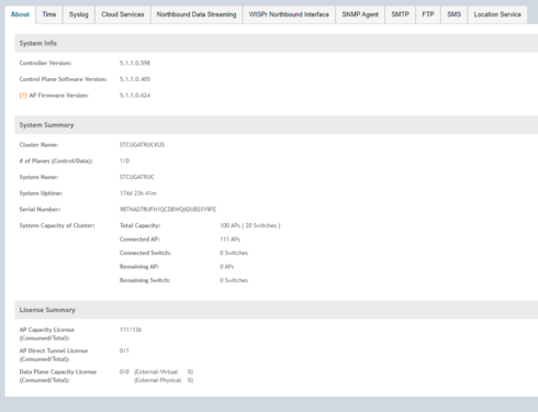

Hello everybody. This is my first post as i'm new to Ruckus world. We are having problems adding new APs to Controller. Every 60 sec we have a heartbeat lost from the controller to AP and the AP firmware still diferent than Working APs. Here's some screenshots, if you need more info please ask.

It seems you have exhausted system hardware AP capacity.
Refer the screenshot below, system AP capacity (as per current hardware resource allocation) is 100 but you have connected 111 AP (11 additional APs) due to this system is unable to manage them properly and APs are getting disconnected.

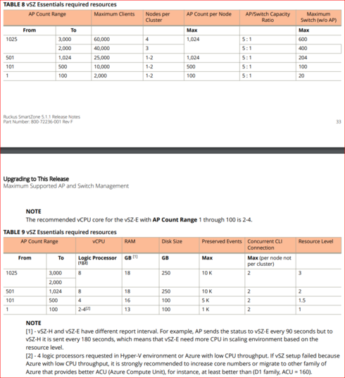

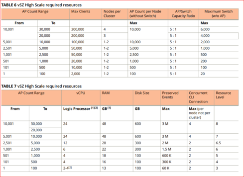

To fix this, please increase the hardware resources from your VM for vSZ instance. You can refer the below tables (refer it depending upon your vSZ type, vSZ-H or vSZ-E) and increase the resources accordingly.
For vSZ-High scale:
Image_ images_messages_5f91c454135b77e247a27d06_282b816c9f22dfa98a4eef7a24ce29c5_RackMultipart20200121914471ou3-35256c00-4a1d-4174-8ffb-12640568b9c2-1209417140.png1579602215
For vSZ-Essentials:
Image_ images_messages_5f91c454135b77e247a27d06_82b5bfd35d4cb743a0bd61b030277269_RackMultipart20200121912651d24-de101845-fe94-471d-a483-e2392b20d1cc-1328118707.png1579602261

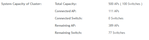

Hello,
Everything is working fine after increasing the hardware resources and we can add more APs. In system capacity it shows that the total capacity changed to 500. 🙂Image_ images_messages_5f91c458135b77e247a36494_2f2f5a5409afd5cac72b1993265d8c04_RackMultipart202001281138519zz-9f9c6178-954e-4026-880b-ecf0eed112db-1244348617.PNG1580228821
