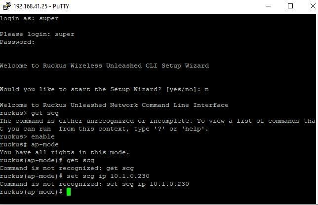

I am trying to convert the Ruckus T310 AP to join our managed smartzone controller. I have done this for our R310/R510 numerous times withou any issues but the putty commands don't appear to be the same or work.
I feel it needs a particular software install on it to work but I can't seem to find it or if its even possible!
Any help would be greatly appreciated.

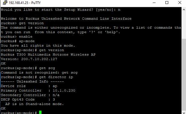

Hi, I have upgraded the firmware but the commands to set the SCG still don't work.
Thanks
Image_ images_messages_619673f914a66e5df74fe8f2_500b42466eccf10ae582c86b0ca5a560_error2-8dde5544-2575-40bc-b928-8e7e3b1e5d8b-1592513277.JPG

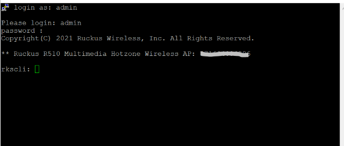

@luke_blundell If you look at the top line of CLI it says "Unleashed CLI". The AP version is Unleashed 200.x and not Standalone 100.x or any other. FYR below is how an standalone AP CLI looks.
Image_ images_messages_619674aa14a66e5df74fe8f7_4c155b974ff6428da2dc1b4b3f30677b_APCLI-4eafa290-6759-4ac9-86d8-5600c6110244-2043336972.PNG
Best Regards
Vineet
@luke_blundell
Hi Luke,
The AP is still on the Unleashed version. Have you tried a factory resetting the AP after isolating it from the Network and then upgrading via CLI?
Try to upgrade from CLI via FTP/TFTP by following the below URL:
https://support.ruckuswireless.com/articles/000001551
If you have any further issues, please open up a case and we will assist you to upgrade and connect the AP to the controller over a remote session.
