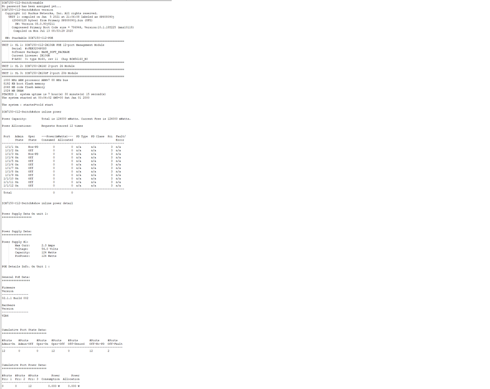

My switch stopped working. After a discussion with a technician, the unit had a problem with a port.
The technician said I need a replacement. Please see more info below.
This is the serial number: FEK3217R1VM
Thanks for your reply.
Based on the troubleshooting and the images you have shared, seems that the management port is not responding this unit should be RMA (return merchandise authorization) in simple words replace it.
Feel free to contact us via chat, comment you already have a post, copy the link from the post (URL) and paste it into the chat to start unit replacement.

See below info your IT requested.
