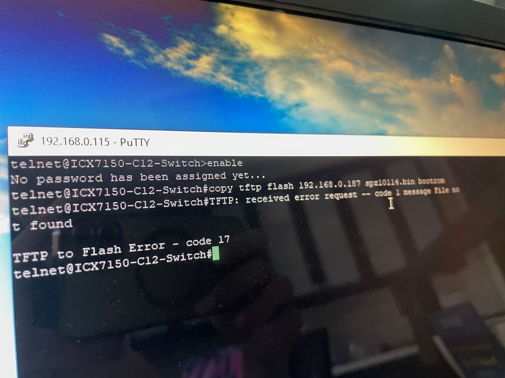

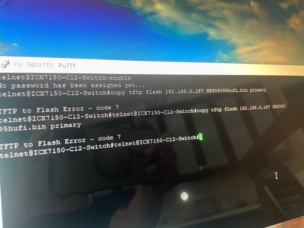

06-24-2023 07:23 AM
When typing the last code from my computer to this it shows the following error
