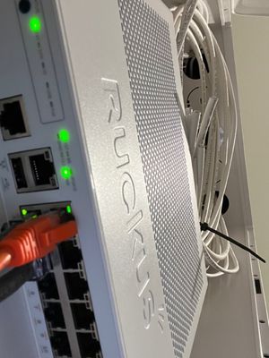

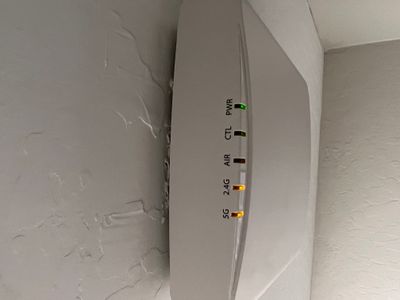

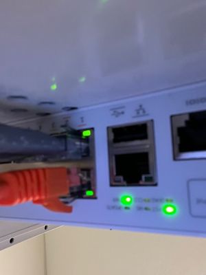

Could you please let us know if you performed the factory reset of APs as described in the previous post and what is the light status of the APs and Switch? Please share the pictures showing the light status Switch and APs.
Thank you again.
Lennar Home Community.
Factory reset was performed numerous times on the switch and APs. Like stated before the Configure.me.x.x.x.x never appear as an wifi options so I’m not able to start the set up. Light status for switch and AP are attached. Please advise on what I can do to get this issue fix.

Hi @PC
From the pictures you shared Switch and AP lights are in a normal state. (Please refer to below link for the same)
