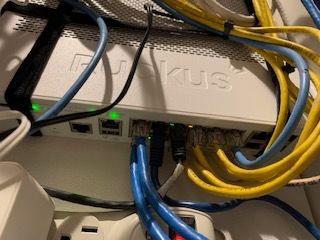

1. Please refer to the image below and share a picture showing the light status and the full panel cable connections to the Switch ports.
2. Could you specify how many Access Points are currently connected to the ICX-7150-C12P Switch?
Additionally, please provide pictures of the switch displaying the status of the lights and the cable connections to the Switch ports.

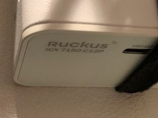

3 ACCESS POINTS CONNECTED3 ACCESS POINTS CONNECTEDMODEL NUMBER OF RUCKUSMODEL NUMBER OF RUCKUS
Hi @Jacoby1
Thank you for your response and the information provided.
Regarding the status of the RUCKUS ICX-7150-C12P Switch, it appears that the switches are operating normally. However, the Power over Ethernet (PoE) ports on the switch may have been disabled, resulting in the Access Points not receiving power.
To troubleshoot and resolve this issue, please refer to the following RUCKUS Lennar Knowledge Base article:
https://community.ruckuswireless.com/t5/RUCKUS-Lennar-Support-Knowledge/NO-Power-on-Access-Points-an...
This article provides detailed steps to diagnose and rectify the lack of power to Access Points connected to the ICX-7150-C12P Switch.
Should you encounter any difficulties during this process, please do not hesitate to reach out for further assistance.
