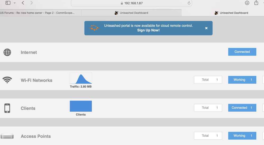

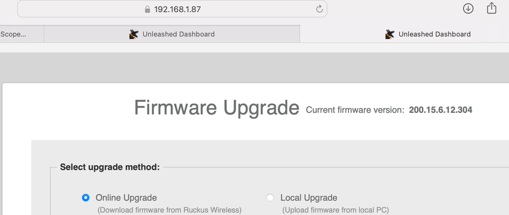

I followed the steps and was able to update the upstair AP but unable to log in to the 1st floor AP even tho its giving out wifi with internet.
They were both red before but the the upstairs changed to green randomly. therefore, when I went to 192.168.1.86 it does not work.
192.168.1.87 works and I was able to update it but its only showing

Hello @wholes,
I understand that you have upgraded the upstairs AP to the recommended version.
Could you please confirm if the upgrade was performed on the first floor AP too?
The upgrade should be performed on all the APs in the network and all the APs should be in the same version
