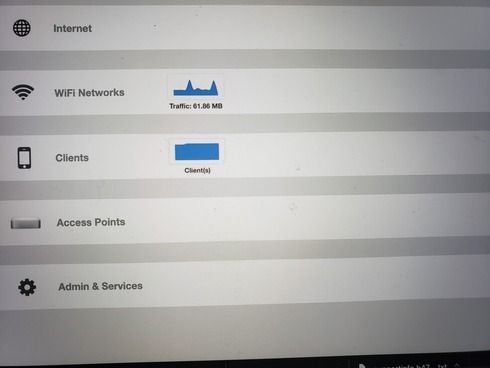

Hi Rob, you have a screenshot of the portal page where to check for this?: verified if the R510 is connected to the ICX at 1000Mbps full
Options
- Mark as New
- Bookmark
- Subscribe
- Mute
- Subscribe to RSS Feed
- Permalink
01-10-2020 03:54 AM
Under Access Points, select the actual AP, expand Show System Overview Info and look under LAN Port Status.

Options
- Mark as New
- Bookmark
- Subscribe
- Mute
- Permalink
01-11-2020 10:37 AM
Actually, i saw that before, but its just a label of what the port will support. Wasn't too clear that my current operation is on 1000Mbps? like connection status: 1000Mbps, which would be more clear. I remembered the Up was 1Gbps on eth0, but was not sold on that was the actual.
