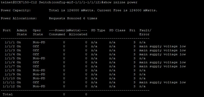

Hi.
I'm currently running into a problem with the ICX7150 network switch. Currently there is no power flowing through the APs. A temporary solution involves resetting / power cycling the switch and enabling inline power again. However, the main supply voltage low error keeps showing up after a few hours. What does this mean and how can I prevent this from happening? The router is booting and I am able to get wifi for a few hours before it shuts down.
