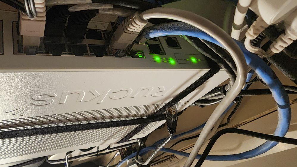

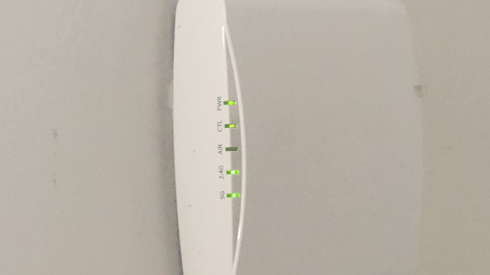

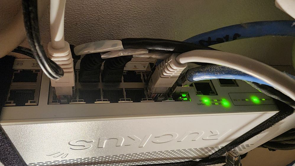

after we switched internet provider only one of two access point shows up on available Wifi and only 5G. there used to be upstairs & downstairs wifi login with both having 5g & 2.4g. without the 2.4 my thermostats are not connecting to wifi. upstairs access point has 5G, 2.4G, & PWR green light. downstairs has 5G, 2.4G, CTL, & PWR green light. what need to be done to return it to how it was?

all lights are green & everything connected Ethernet working fine. my house thermo20260120_193728.jpg20260120_193852.jpg20260113_161252.jpgstats & mini split require 2.4G.

Thank you for your response and for sharing the detailed information.
Based on the images you provided, the switch cable connections and LED/light status appear to be normal.
If the 2.4 GHz network is not working, you may try one of the following steps:
  • Create a new Wi-Fi network (SSID) specifically for the 2.4 GHz band, or
  • Edit the existing Wi-Fi network settings to ensure the 2.4 GHz band is enabled and configured correctly.
