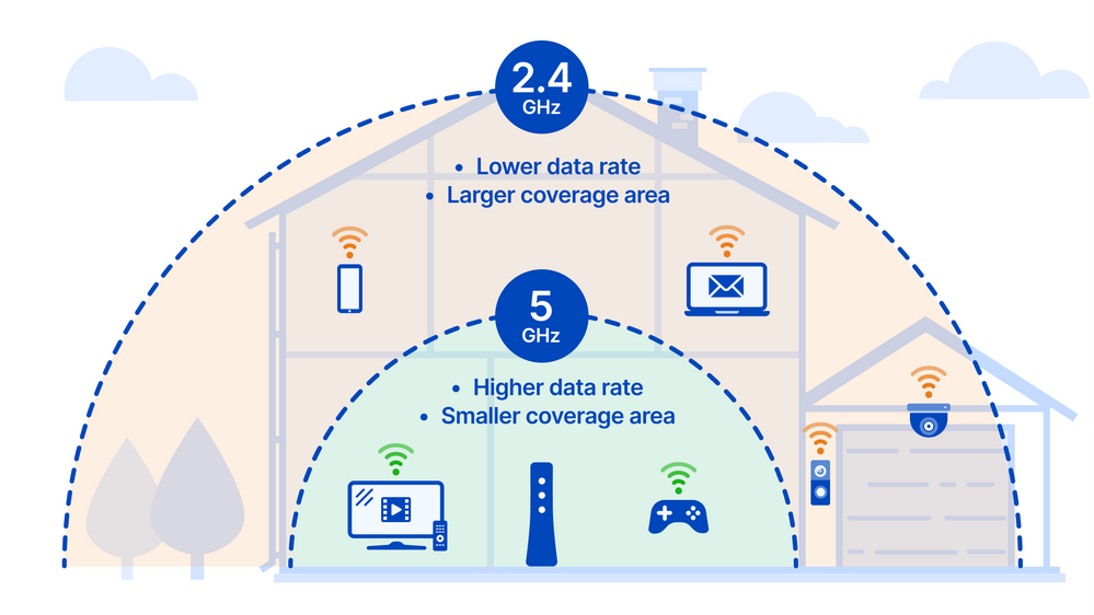

More details for the radio 2.4G and 5G
A 2.4 GHz connection travels farther at lower speeds, while 5 GHz frequencies provide faster speeds at shorter ranges. That depends on whether to use 5g or 2.4G will depend on the end device (such as phones/pc/ring door/Mac devices/iPhone) They choose whether to use 2.4g or 5g auto. It will also depend on the network (Wi-Fi / SSID / WLAN) configuration if it is 2.4 or 5G only.
A lot of electronic devices and appliances use the 2.4 GHz frequency, including microwaves, baby monitors, security cameras, garage door openers, and phones.
