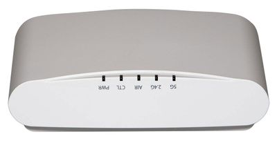

How are the color lights from the Wireless Access Point

Regarding color lights from the AP:
for all the three APs (located at each floors) in the house, they all have two green lights on PWR and CTL. The PWR is flashing often.

Based on the color lights here is the meaning PWR flashing.
https://docs.commscope.com/bundle/unleashed-200.9-onlinehelp/page/GUID-19D4261B-D10B-4DE3-B63A-3498F...
System started, no routable IP address detected.
Basically, the xfinity device doesn't provide IP addresses to the Ruckus devices, so it can't broadcast the network correctly.
Basically it is not giving IP  address through the ports (DHCP) if you already checked that the connections are as in the photo you are fine.
