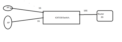

Hi @MichaelH
Sure, let me share the link, however the ICX7150 must be connected to a device that has an SFP port and require using an SPF cable that can negotiate 10G speed, so if the ISP router is 2G port, will negotiate to 1G only, now there is only two SFP ports and the Access Points will negotiate to 1G because are 1G Ethernet Port, now we are talking about wired data transfer, the wireless environment will be another thing.
