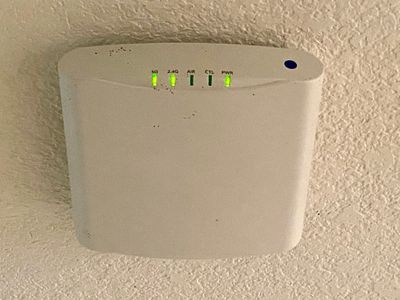

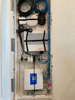

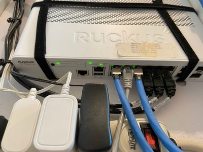

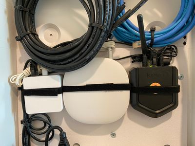

One AP please see the images I sent of all the equipment thanks!
05-17-2024 07:37 AM
here again
05-17-2024 08:08 AM
Hi @RFadtke
As per the light status of the RUCKUS ICX-7150-C12P Switch and R510 Access Point, they are in a normal state. Even connections seem to be correct.
Please note if your ISP modem is directly connected to the ICX-7150-C12P Switch, it doesn’t work only with Modem. The connection must be from a Router or Modem-Router combo device. Could you please confirm this once?
Please refer to the short guide link below about how to connect the devices as a reference:
If the Switch is connected with a Router or Modem Router combo as described above, please unplug the ethernet cable from the Switch port and connect to any other 1 in-12 ports (as highlighted in the below screenshot) once you plug it into the other port, please reboot (unplug and plug from the power outlet) your ISP Router and the RUCKUS ICX-7150-C12P Switch once.
