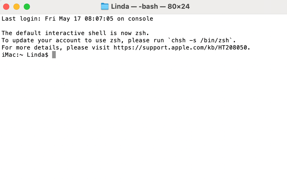

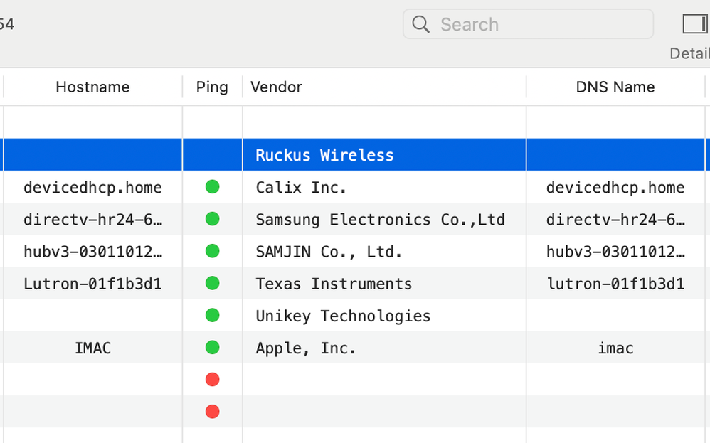

I downloaded the ip software, but the ruckus device does not have an IP address, just a MAC address. I went to terminal and got the attached information. I am out of my depth on this part and could use some help! Thanks. i tried to upload a picture of both the ip address and terminal but it won't allow me. terminal is telling me the enteractive shell is zsh and i would need to update.

Please note, the Switch MAC address won’t work to access CLI. We need an IP address for the same.
Before uploading any picture please log in to the RUCKUS account and you can upload the image.

Please check the other IP Addresses from the IP scan results, by the name of Ruckus Wireless or Brocade Communications to confirm the IP address of the Switch. Try to log in on the web Switch portal.
05-17-2024 09:35 AM
The ruckus wireless is the only one that doesn't have an IP address. I am using Mac with Sonoma OS.
