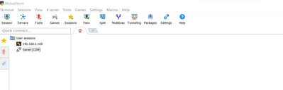

Open Mobaxterm and click run. You should get to this page:
Serial is what I clicked to open that black page with white lettering (coding page?).
Type "admin", click enter
Type "Lennar" click enter (when typing this in, I never saw the letter appear. I just trust they were there.
4.) Follow these prompts like Vasquez highlighted in the above posts.

I do not get serial at the user session.
11-11-2022 11:27 AM
Hi @CK
You need to try another cable many times the cable that is used to charge USB to USB-C devices does not work properly
Also make sure you installed the drivers
Best Regards
