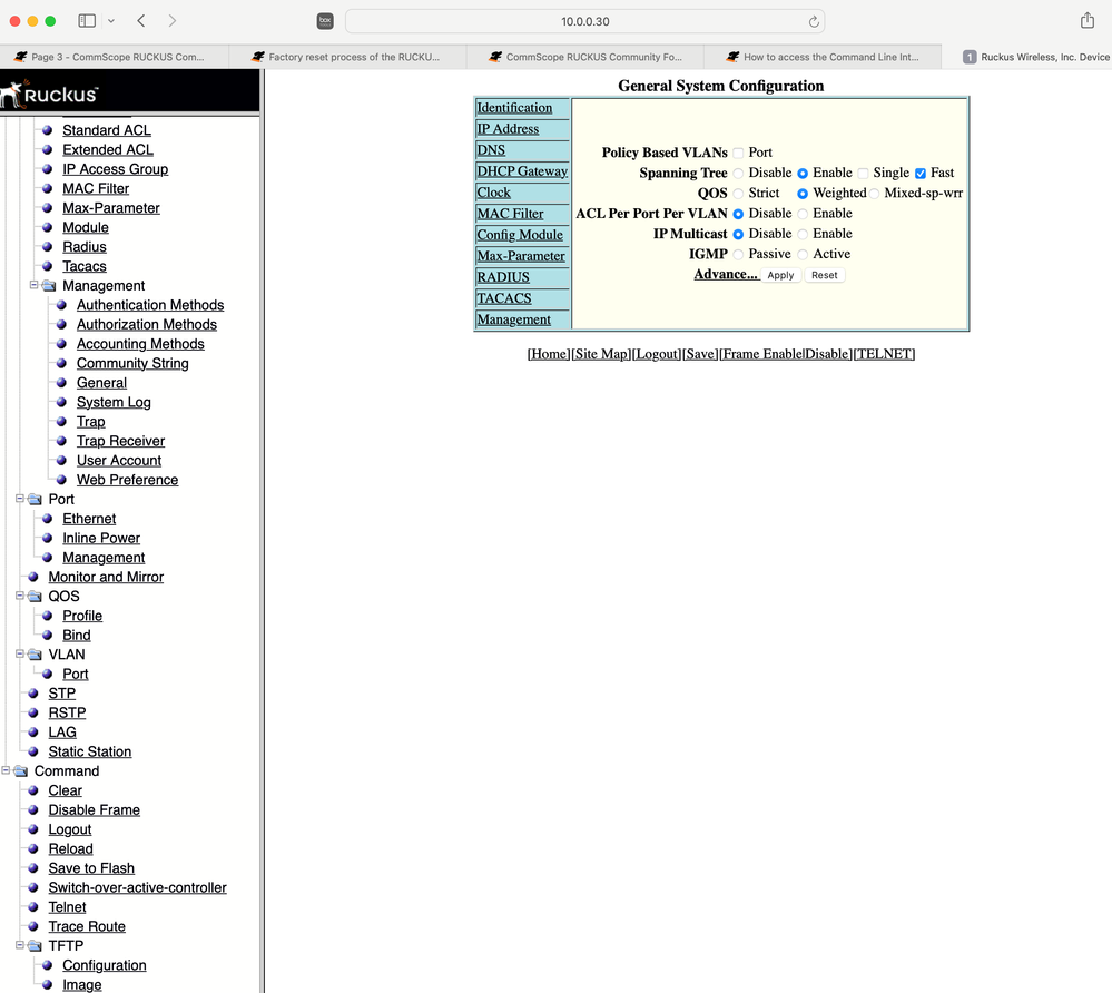

Ethernet is fine but none of the Access Points are working suddenly, Wifi network lost.
01-22-2024 11:47 AM
This is what i could get into via the switch IP address but I don't know the rest of the step. Please let me know what I need to share you with

Hi @chris_chau
Could you please share a screenshot showing the below information?
01-22-2024 12:08 PM
01-22-2024 12:28 PM
Hi @chris_chau
I see your Switch is on an older version may causing this issue.
We suggest you upgrade your Switch to a stable 08.0.95g version.
Please refer to the below RUCKUS Lennar Knowledge Base guide for the upgrade process.
Note: Ignore 08.0.80f version from the guide and upgrade directly to the 08.0.95g version directly. Since your Switch is already on a version after 08.0.80f.
