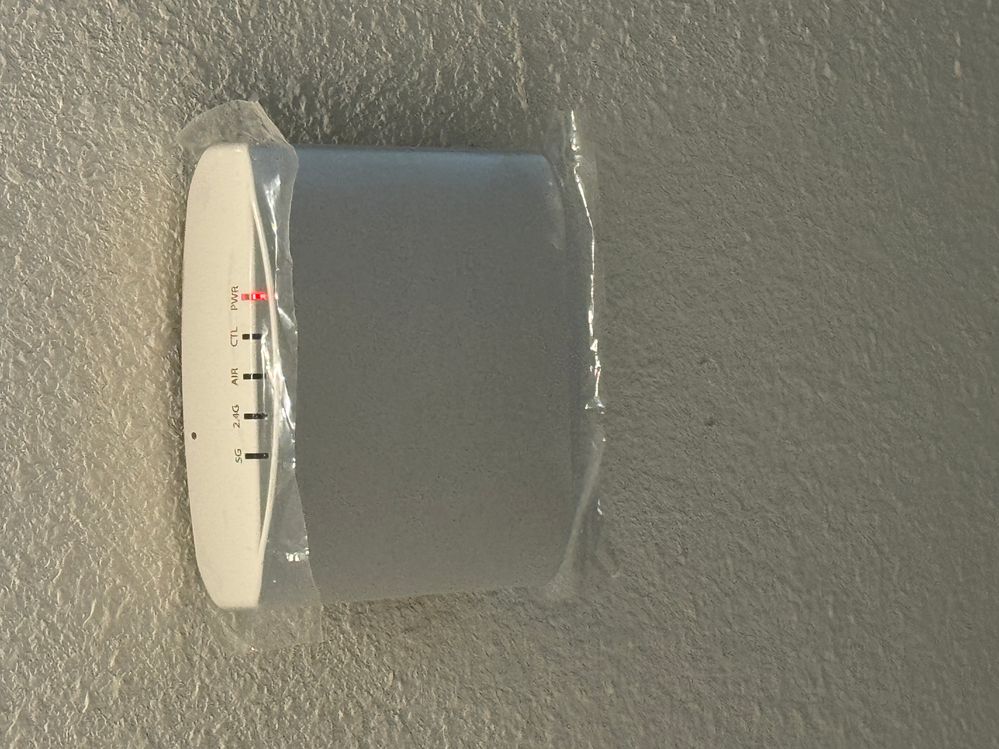

Hi, I replugged the ISP cable according to your recommendation and reboot the Switch and it doesn't make any difference. All LAN ports are working fine, however, the 3 APs they were originally working are now rebooting repeatedly and same as the other 2 APs so the entire wireless network is now lost
This one of the three that was working but now it's rebooting non-stop, but according to what happened over the weekend this one will eventually come back to normal but it'll take ~10 hours for them to come back, but the other 2 APs are still rebooting and never work. There is definitely something wrong with the AP settings I feel like. Can you log into the switch and check?

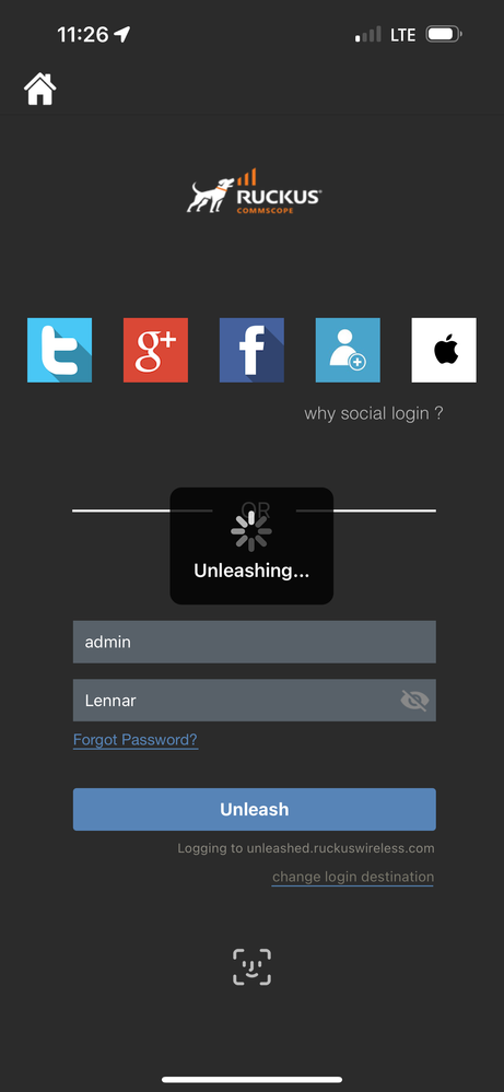

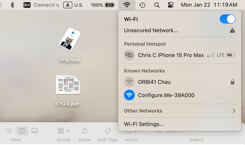

Hi, I followed the instruction to unplug all APs from the switch, expect for the one that I perform the reset at. After the reset, I was able to see the AP "Configured.me-xxxx" but I could not go further as the AP restarted again in less than 30secs so I didn't have time to do anything since it still keeps rebooting itself. Even if I tried to login to this "Configured.me" network via the phone app it doesn't go anywhere.
