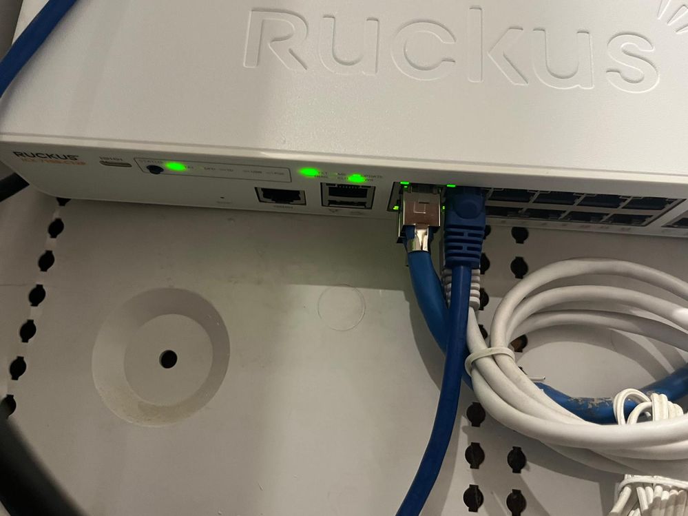

2) Please refer to the below picture and share a picture of the same, showing the light status and the FULL Switch panel cable connections to the Switch ports)

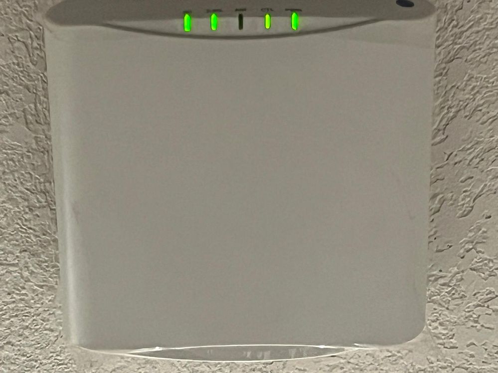

3) May I know how many Access Points are connected to the Switch? Could you please let me know the light status on the Access Points? Any of these lights are on (Please refer to the below picture and share a picture of the same)

2)Please refer to the below picture and share a picture of the same, showing the light status and the FULL Switch panel cable connections to the Switch ports) - Please find attached.
3) May I know how many Access Points are connected to the Switch? Two Access Points
Could you please let me know the light status on the Access Points? Any of these lights are on-- Yes lights are on, refer attached.Switch ICX 7150-c12p
Access Points R510
